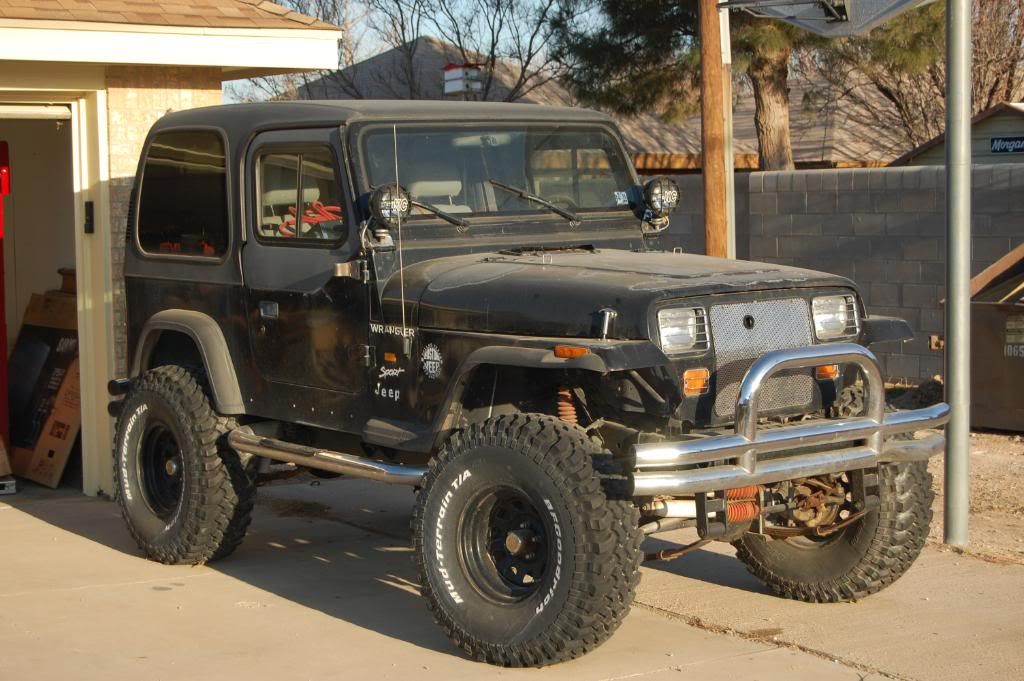

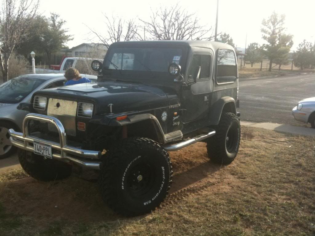

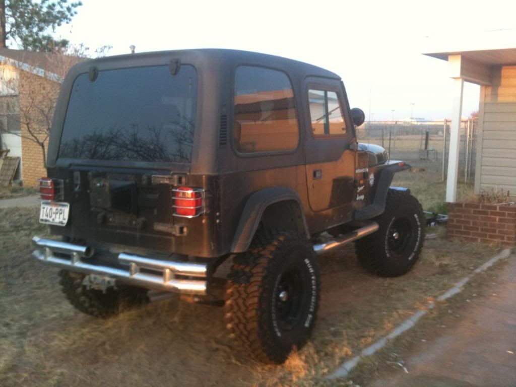

I wish I could find the pics of it from when I first bought it but have no idea what happened to them. It had stock tires on it & a worn out soft top when I first got it. Here are pics of it after I added the Bestop hard top & 35" BFG M/T's.
