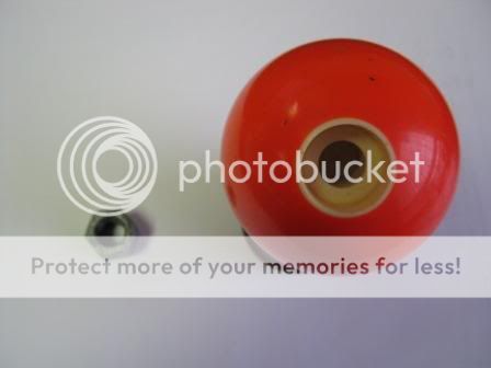

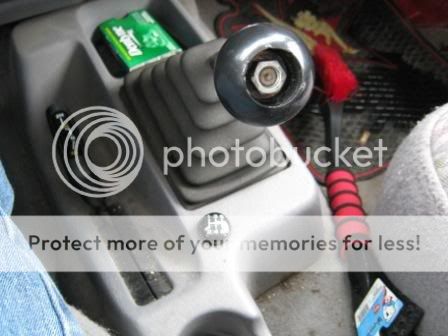

Replacing the stock shifter knob is a piece of cake.
To remove existing knob, pry off the cover and undo the retaining nut.
Get a pool ball and the retaining nut you just removed.
Drill a hole into the pool ball like the one shown.
cont'd.........

........cont'd.
A lathe is very useful for drilling nice holes :D
Epoxy the retaining nut into the pool ball.
And voila!, you're done.
Just make sure that when you glue that nut into the pool ball, the knob will end up oriented the right way when you install it.
