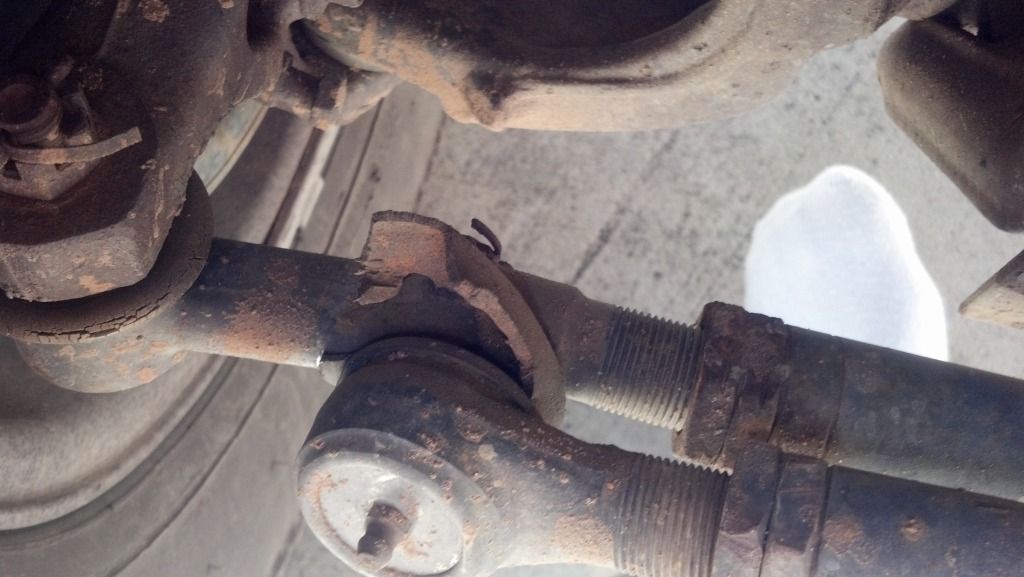

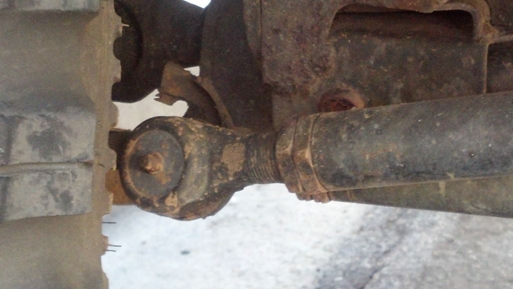

Ok, well I need new tie-rod-ends. My steering is not stock but I don't know what it is. I bought the heep already modified. Can anyone tell me what TREs I need please?

Those look real similar to chevy 1 ton TRE's but I could be very wrong You would have to take measurements to find out. On The shaft it will be a 7/8" x 18 threads. The part number for the passenger side would be ES2233L and the driver would be ES2234R. Once again I would research them a little to see if those are what was used on your set up, they are failry common. For the drag link the lower should be stock jeep sized, same with the upper.
Just remember I could be 100% wrong, just giving out the info I have,

Thank you for the reply. Any information is better than what I had before. :D

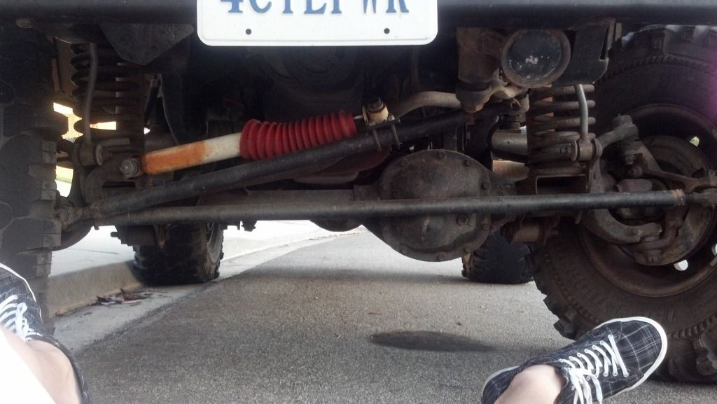

Could they possibly be ZJ Grand Cherokee? Just throwing that out there because I did the ZJ steering swap on my LJ.

I would also look into a drop pitman arm. That drag link angle is not crazy but it looks like trouble with possible bump steer and death wobble.
Just an observation. Drop pitman arms are cheap.
